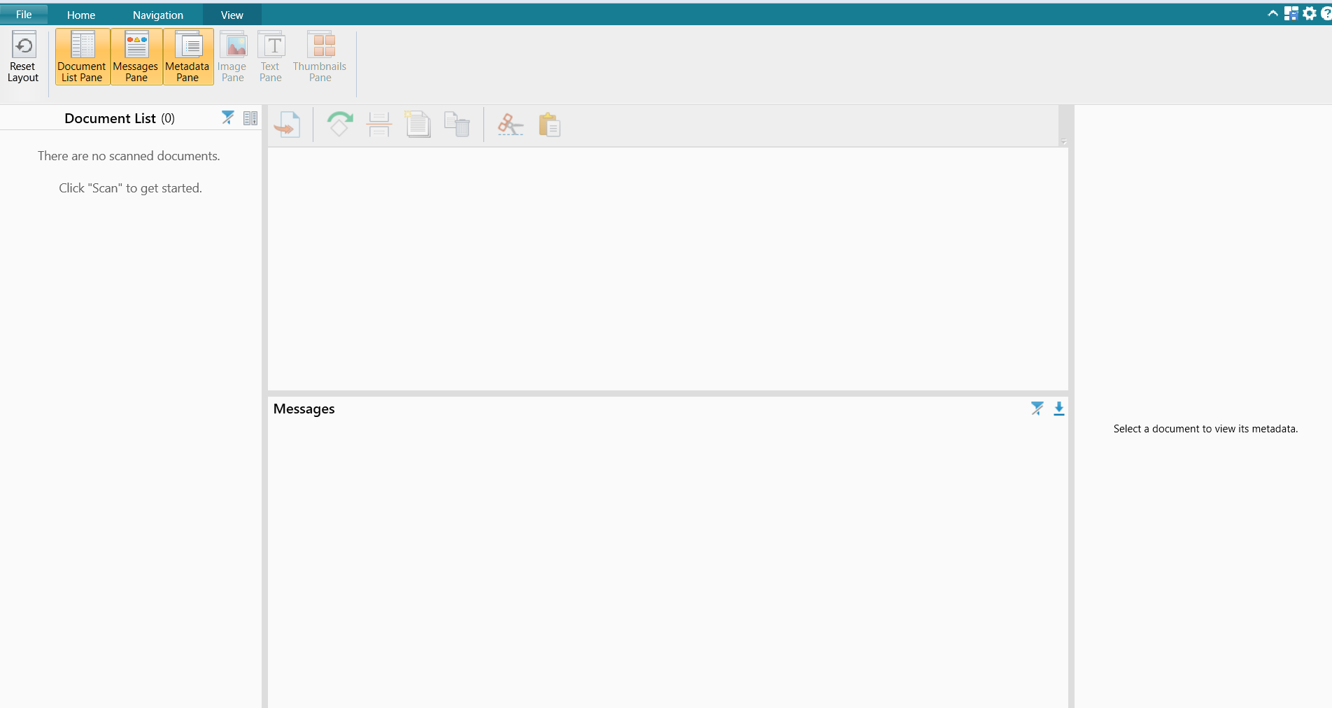

QF Scanning has a Messages Pane, do you see any errors there? Messages Pane can be enabled in View -> Messages Pane

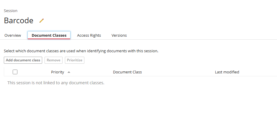

Hi,
Sorry for the delayed response. Currently, I've run into the issue where it publishes the session but within the session, the Documents Classes tab is blank. My account has full admin access.

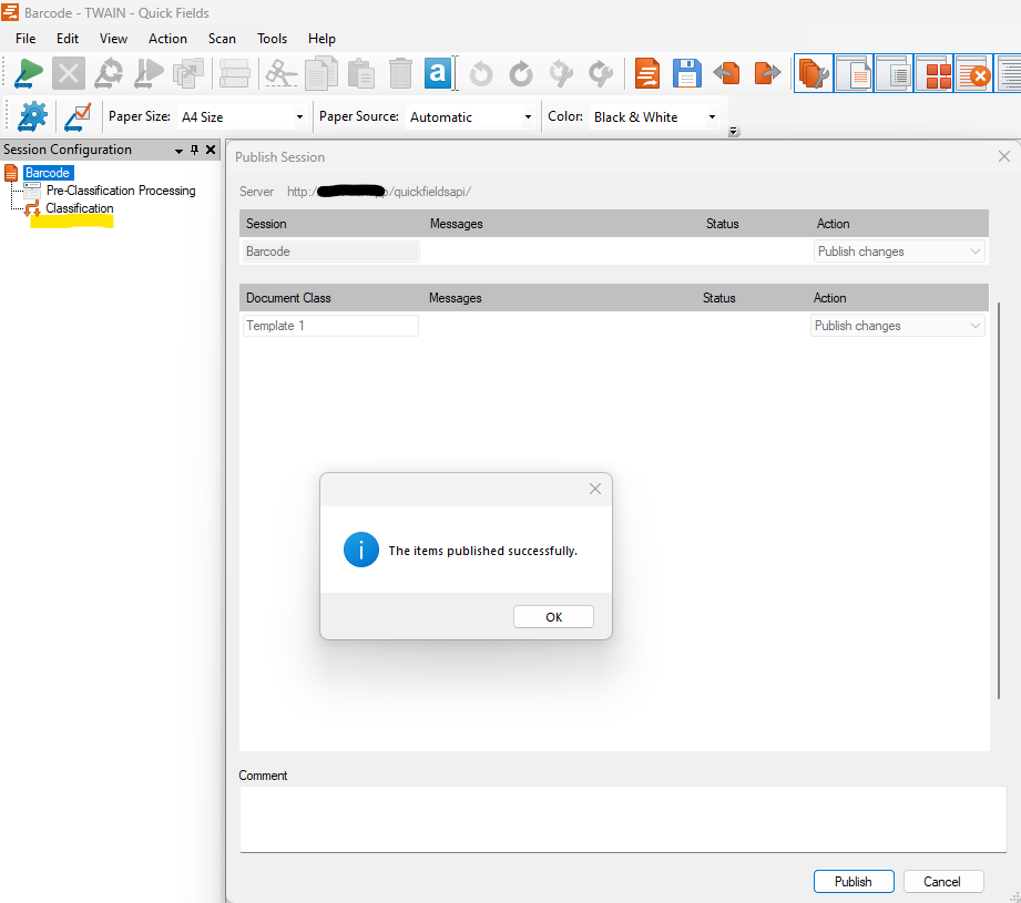

On the Quick Fields app, I go and click Publish Session
Once I hit publish, this is what happens:

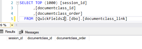

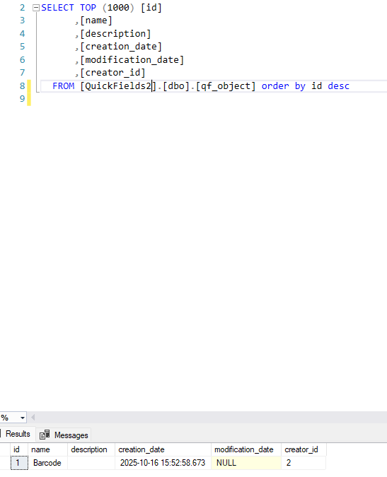

In the database, the session gets created but the [QuickFields].[dbo].[documentclass_link] doesn't have anything.
I even created a new database called QuickFields2.
Could you provide insight as to what I'm doing wrong?

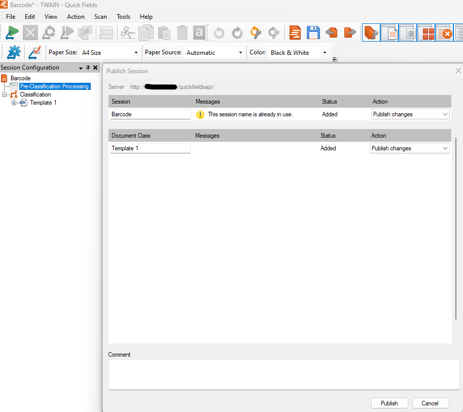

Update 2:
I went here and realized I may have copied a process. I was able to get to work.
Do you know if there are plans for Quick Fields to be updated?
replied on October 17, 2025
We don't have an exact plan for Quick Fields release. I think the bug you mentioned is this bug (ID 320640). I add this post in the bug. So if there is a fix we will reply on this post
