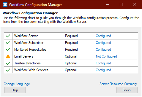

I am looking through the documentation for moving workflow server. In it, it makes reference to a Server Summary Tool. Can you let me know where I can find it?

replied on October 20
It's this link right above the "Finish" button the Workflow Configuration Manager. You can access this utility from the Workflow Server.
