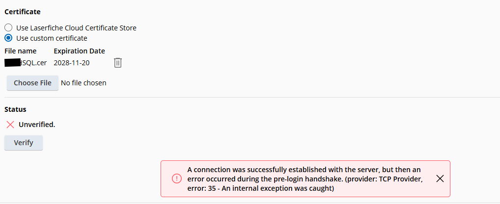

replied on November 20, 2025
I've tried a base64 and get the same error:
