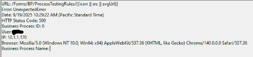

We got an error from a business process which caused the Routing service to crash immediately afterwards.
But it says Business Process ID: 0 and Business Process Name is empty.
How do I find out what process this is so that we can prevent it from shutting down the primary service

This UnexpectedError is a browser bug in Chrome version 137 and above. It does not cause the routing service to crash. To identify the cause of the crash, you need to check the application log or enable the diagnostics debug log to see what happened before the crash.
