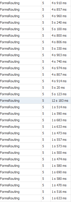

We upgraded to the Latest Version 12, 6 months ago, We have noticed significant time differences in  Workflows which have a Database connection using Advanced connection type...

FYI - Changing Connection type to ODBC / Direct the speed is the same as Post Upgrade so LF 11 = LF 12 Times on anything other than Advanced.
Highlighted Row shows the time the WF Version was upgraded, Nothing else in our environment had changed
Startedby - WF Version - Completion Time

Identified as a Bug in WF, no indication of a time frame for a fix to be implimented. WF Bug-ID #617030

Hope your well, Unfortunately they have only said they are also able to reproduce the issue, So nothing more than that, than logging the bug #.
However what is interesting is you can still use named Variables in your SQL Script, for say stored procedures in the advanced DB task, So after much head scratching and complaints from end users of slow systems, we were able to identify changing the connection type to Direct gained us over 3 - 4 seconds per WF which had a DB Connection type which used to be Advanced using .NET, so that is the current work around until the bug fix is implimented.
Luckily for us we used a global profile, for the connection type, so we only had to change it in Workflow Admin Console, which worked out quite a simple switch over.

The code was revised last year to address some security issues found during our internal scans. The query run time was not affected, just cleaning up the connection afterwards rook a hit and was taking about 2 extra seconds.
