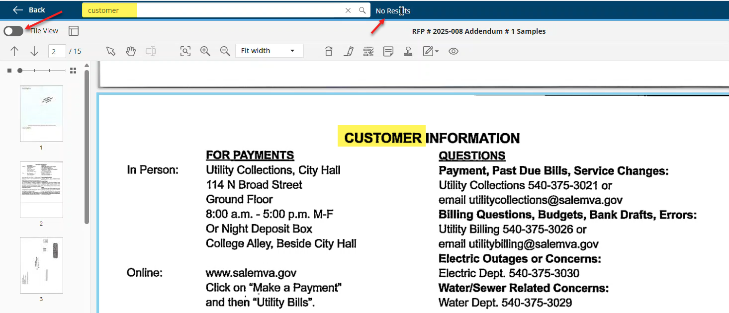

In one of our repositories, we do not generate pages and searchable text on import, but occasionally we want the PDFs to be searchable. It will allow us to generate pages and searchable text from the menu, but the text still will not allow searching.  The text quality is good. Please see attached video. The same happens with the desktop version.

It's not generally necessary to do BOTH generate pages and generate search text separately. Generally the process of generating pages will also add the text to the search index - generating text is usually a process you can do separate for documents that already have images. Also, when used through the repository web client, generating text is not a simultaneous process - it's either offloaded to DCC (for self-hosted) or the Cloud text generation service (for Laserfiche Cloud), and there may be a delay before the text is returned.
Lastly, you are in the file view (viewing as a pdf) and the search you are using is the embedded adobe reader search, so none of the above options will actually impact that. You can tell this because that's an adobe reader toolbar, not the Laserfiche document viewer toolbar. It will only be able to search on text if the PDF has an embedded text stream, which is a property of the initial PDF itself, not generating text through Laserfiche. Having generated pages you want to toggle to the page view and then Laserfiche search will be used for search operations.

Thank you for your reply, Justin. I can't get the search to work when the file view is toggled on or off.

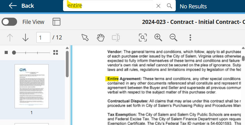

I just wanted to mention that we have verified that the full text search service is running on our application server and we also restarted it, just in case. I have "generated pages" on several other PDFs in the repo this morning with the same result.

Does it work if you do a text search from the repository as a whole? One interesting thing is that the word IS getting highlighted, which means text has been generated there and affiliated with the text for it to find it - it's just not showing from the doc viewer search.
replied on September 23, 2025
I highlighted that to show you where it exists, it doesn't find it. It does not find it if searching document text from the repo as a whole either.
It does not find it, I highlighted the search term and where it exists just to show that. Unfortunately it does not find it from a document text search in the repo as a whole either.
Ok, sounds like that's something you'd want to open up a support case on at this point, to dig into why it's not making it into your search index.
