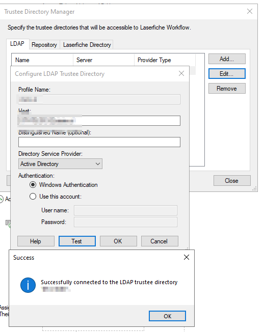

I have created an LDAP Trustee Directory and successfully connected to it.

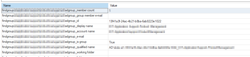

The Find Group activity is definitely finding the group when I run the workflow:
I know there are seven users in this group but the group membership count is only 1. And it must just be the name of the group because when I try to run it through a 'For Each Row' activity, it treats it as if there are no rows at all.

In Workflow Designer, how many members can you see in the members tab?
I hadn't thought to look at the 'Additional Properties' before. Oddly enough, yes, all of the members are returned there.
I opened the wrong version of the workflow that was still using Repository Groups. The version that uses the AD Groups do return any members even though I know they are there.
