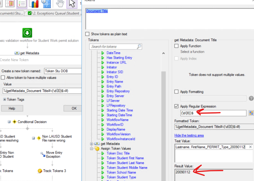

I am using regular expression to extract date from file name:
File name: Lastname, FirstName_PERMIT_Type_20090112
RegEx: (\d{8})$
Date field format: Short date
And getting this error:
Set Student Field Values. The data assigned to field 'Student DOB' is not valid. 9017 [Bad field value. [9017]] [0265-WF10]
Can someone help please to resolve this issue. Workflow is running but date field is not getting populated with the result i am getting from regex

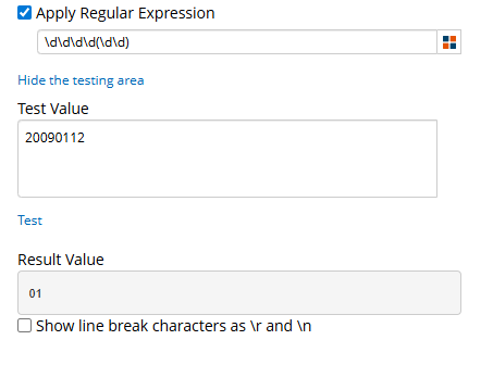

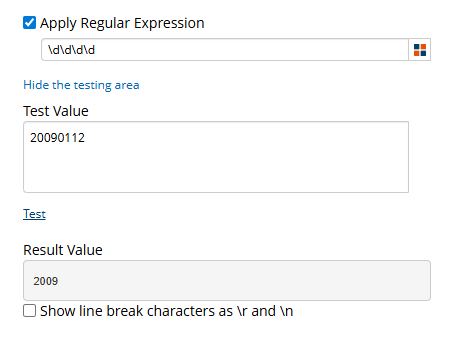

Hey Kartik,
To keep it simple, I'd simply break out the bits you need in separate pattern matches like so:-
Year
Month
Day
Then use the assign token activity and create a new document date token to use in the field activity later on to bind them all together in the format you need. DD/MM/YYY or MM/DD/YYYY whatever the date field is configured to.

replied on September 30, 2025
Hi Douglas,
I am still getting following error:
"The data assigned to field 'Student Date of Birth' is not valid. 9017 [Bad field value. [9017]] [0265-WF10]"
I tried to get Month/ Day and Year separately as you suggested in tokens and concatenate in format like MM/DD/YYYY but the token dialogue is not taking it and not populating the date:
Token dialogue doesn't take the token if i put / in middle
