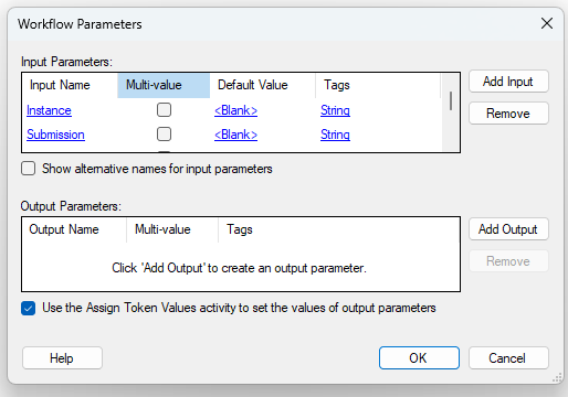

Depending on what kind of data you have, it is possible to do this with Workflow, but you will need the Instance Id and the last Submission Id for the instance you want to replicate.

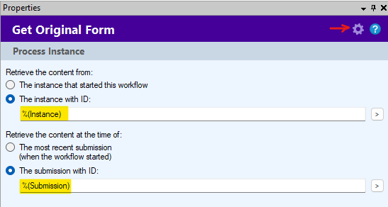

I don't think you can add files/attachments, but you can use Retrieve Business Process Variables to pull form data and Invoke Business Process to start an instance with the data from the original.
  1. Retrieve Business process Variables
    • Use custom settings to set the Instance Id and Submission Id manually because this won't be triggered directly by an instance.
    • I usually configure the workflow with input parameters and use the last Submission Id so it gets the most recent data.

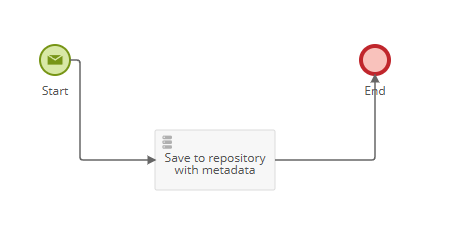

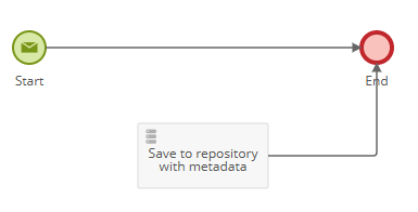

Thank you, Jason, for taking an interest in my issue and providing a solution. However, I believe the problem is slightly more complicated than that. When I created my process, I forgot to link the record to the process.
As a result, the first forms were not saved in the repository (neither the form nor the metadata).
I have fixed this for the new forms.
