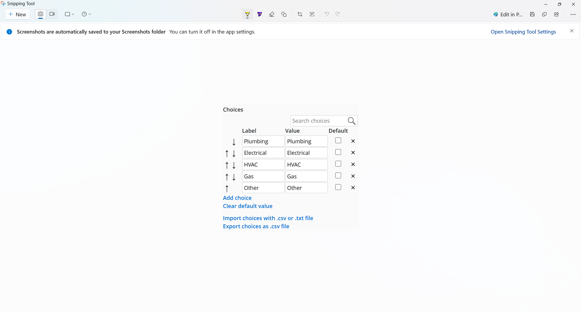

I had a similar problem when saving a forms document to the repository.  I find that with Address, Checkbox, Drop-Down and Radio Button the variables can get a bit tricky. To get the value that was entered in the checkbox to save with the form, I had to enter the value of the checkbox choices next to their corresponding Label (see screenshot below).  You have to play around with the variables to make sure they are pulling the correct information.

Thanks @████████. I tried adding values to each of the fields and still had the same issue. I have a ticket open with our var. I will let you know what the resolution was.
