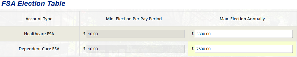

We have flex spending accounts for our employees (FSA), that employees can put money into for medical expenses.  We have one for just the employee and one for employees with dependents.  If the employee is electing just for themselves the annual amount they can contribute is different than if they are electing for dependents also.  I would like to do this in a table and have row 2 of the table have a maximum different than row one's maximum.
Any ideas on making the Max. Election Annually different for each row?

Currently, I ended up doing two different tables.  Each selected/shown by a radio button.

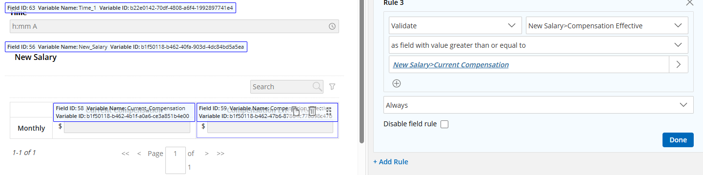

If you put a hidden field as a column of your table you can setup field rules to validate against that field.
"Validate FSA Election Table > Max Election Annually, as field with value less than or equal to  FSA Election Table > Hidden Max Election. Always
This field rule enforces validation based on each row independently.
