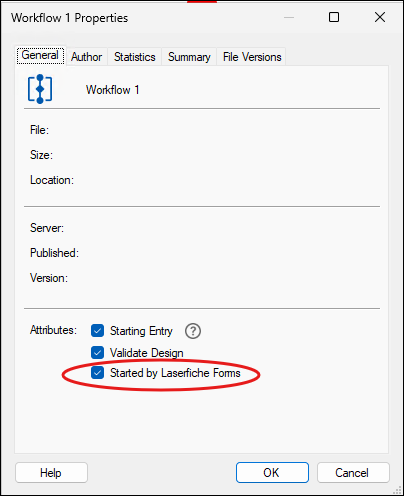

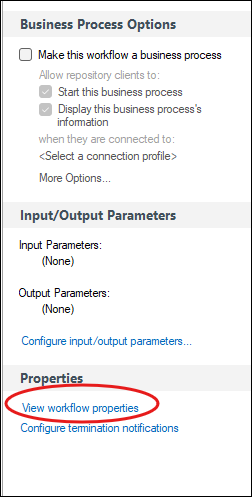

You have to flag the workflow that is is being started by Forms.
Check this box:

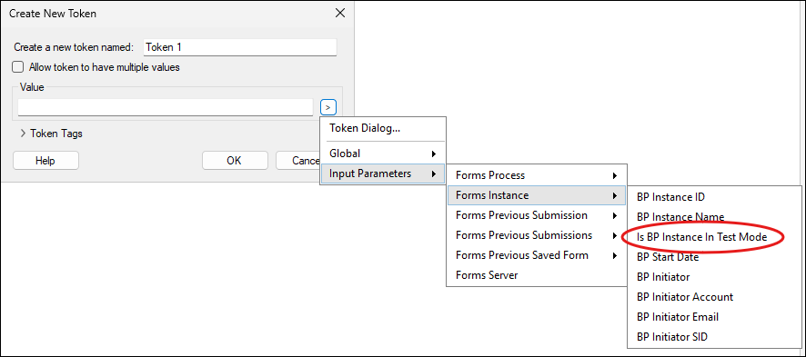

That will enable a new group of tokens called "Input Parameters" that has a bunch of additional details about the Forms instance.
3 0
replied on August 14
The latest version of workflow knows if the form invoking it was started in test mode so in the workflow you can just conditionally exit at the beginning of the workflows you want to skip.

replied on August 15
Oh yeah...now I seem to remember hearing about that at the conference.  I'll look into that for now but I think it would be more beneficial to have that option in the Forms test rules.

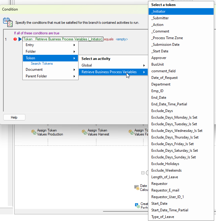

What, exactly, do I look for in the Workflow? I'm assuming I need to look at the Business Process Variables, but I don't see anything that would seem to indicate whether it's in Test mode or not.
Check this box:
3 0
Thanks Matt, I appreciate the detailed info!
