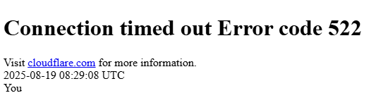

Forms will either not load at all (I get a generic time out error from one of our network providers), or it will load the form half-way showing the title and favicon but a blank page, or sometimes it will load just fine but slower than expected.  It's very intermittent why it works sometimes and not others, and I haven't been able to pin down why this is happening.
I think I've ruled out that it is a network or ISP error, so I'm thinking it has to be Forms.

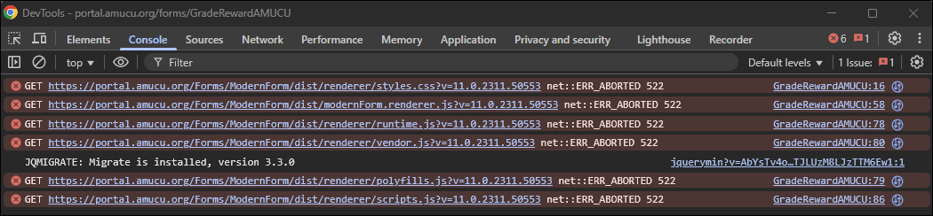

replied two days ago
Console Errors:
And here's two trace logs.  I had to zip them to get them under the 5 MB requirement to upload here, and I also changed the file extension from .zip to .txt so that it would upload them.  You'll need to change it back from .txt to .zip to be able to unzip them.
trace1.har was an example of one of the times it failed and I got an error from our vendor saying that the site had timed out.
trace2.har was an example of one of the times it loaded enough to show the page title and favicon, but the page itself was blank.
I'm far from an expert diagnosing issues with these logs, but I don't think I'm seeing anything in these that indicates the underlying issue.
