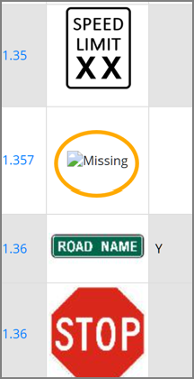

On LF Forms 11 Update 5, using modern designer/ Forms Layout designer,  I've create a printable report that uses dynamic images within a custom html field sourced from a url provided by a database table.  Occasionally, there is a url in the table value, but there is no image available on the server that hosts the images, and my users would like a default visually friendly image inserted instead.
I've unsuccessfully tried to replace the missing image using the onerror attribute inside the img tag solution and using an object/img solution.  Both are not supported in this set up.
Is there any way to set a default image for the missing images?

Sorry, I could have been more clear there. There is a url in the table value, but there is no image available on the server that hosts the images.  For instance, they may add a new sign type to the database and not have completed the task of adding the new sign image to the server.

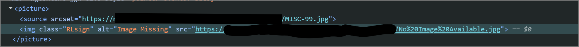

The image is named the same as the sign type identifier, and the url is contructed leveraging that structure.  The html content is updated using javascript LFForm.changeFieldSettings.  The Onerror solution produces this message in the console:

Can you share the code that you've tried using "onerror"? It should be calling a JavaScript function to change the src to your default image.
replied two days ago
<div class="RLsign" style="text-align:center; max-height:75px; max-width:75px;"><img src="{/dataset/Road_Log/MUTCD_url}" onerror="this.onerror=null; this.src=&quot;https://EnterImageURL.jpg&quot;;" style="max-
height:75px; max-width:75px; vertical-align: middle;"></div>
I tinkered with a couple styles of quoting but it didn't seem to matter.  It renders in the Custom HTML preview but gives me the above message when previewing or starting the form.
