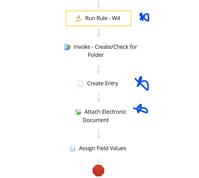

Your form (business process) need a workflow with a document merge activity in it.
Your bp send the form variables to the workflow. The workflow has the input variables configured and are the form fillable fields in the pdf.
The blue starred activities are the ones you need. The document merge rule (run rule - w4), then you need a 'create entry' activity that creates a entry (document) in the specified folder, then attach the 'run rule' activity to the 'create entry  - output entry'.
Here's the snippet of the workflow that the business process calls:
Here's a snippet of the properties of the 'attach electronic document' activity:
replied one day ago
That worked. Thanks so much. I would of never put that together that way but I can see how that works now. I had it close the first time with the create entry just did not thave the attach settings correct.
