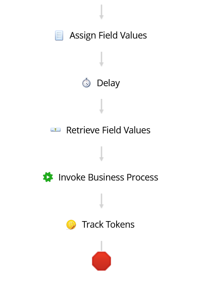

Looking at Smart Fields more and setting up a POC.
1. Invoice document comes in which triggers the workflow.
2. Workflow assigns my Smart Fields template.
3. If I wait a bit the fields get populated.  Take 30ish seconds for the Smart Fields to kick in and populate the fields.
4.  I then want to retrieve the field data and invoke a business process.
This seems to work but how can we tell when Smart Fields are complete?  Right now I just have a minute delay in there.  This seems to work but wondering how you can tell the system to wait until the Smart Fields are completed before moving on.  The minute delay has a chance of not being long enough or wasting time if it completes quickly.

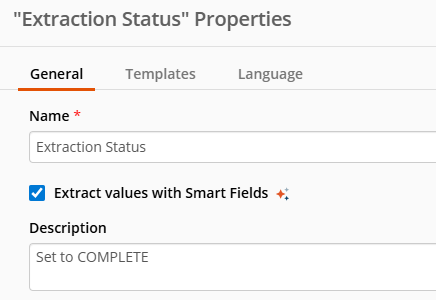

In some cases you may not be able to guarantee a value will be extracted from the document.  You can either provide instructions in the description when configuring the field to insert a value if nothing can be found. Or you can configure a separate field in the template that would indicate the status of the extraction.  For example, create a new field in the template and call it something like Extraction Status with a description of "Set to COMPLETE".
This will ensure you have a value that the wait condition can detect on.

I noticed that if I ran a workflow with multiple entries that the extraction would get out of sync and not complete. For example, I 'For each entry'd 100 documents and changed the template from a non-Smart Field template to a Smart Field template to kick off the extraction. Only about 20 of the docs got extracted.
Once I changed the workflow to 'wait for entry change' and added a 'Extraction Status' field that set to 'Complete' after being applied all of the docs got 'smart fielded'.

There isn't per se.  If the template is setup as Smart Fields, simply assigning the template seems to trigger the extraction.  So the first activity simply assigns the template.  Then Smart Fields trigger automatically.  Someone can correct me if I am wrong but there doesn't seem to be a trigger to kick off the AI extraction.  It just does it when the template is assigned.
The data shows up in the template and then I retrieve it and its there.  Since there seems to be no mechanism to trigger it via workflow I have to wait an unknown time to make sure it finishes.
