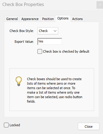

Hi Miruna,
I do have control of the PDF. When you refer to the values for on/off, are you referring to what I'm seeing in the screenshot below?
replied on July 15, 2025
I think I got it figured out. I change the export value on the checkboxes to "True" (not sure if I needed to do this or not), and then make an input parameter in the workflow for each of the 15 options in the checkbox field on the form. The business process fills each input parameter with either true or false, and the input parameter is the token I use for each checkbox in the merge rule. Seems to be working.
