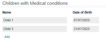

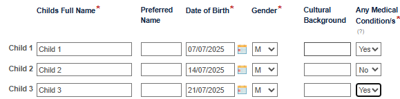

I have this source table;
Rui Deng helped me with code to extract Medical Condition = "Yes" values to a separate table (thanks Rui, that is working well);
Now I am trying to extract these "Yes" values from this table to separate fields so they can be seen individually later in the form.

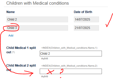

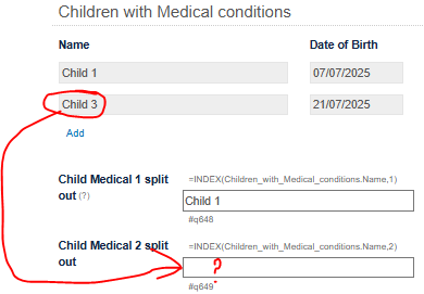

But this is what happens; If lines 1 & 3 are "Yes", I see this; (1  copies but not 3)
Calculations used have been added to the value above the field for your reference.
As you can see, row 1 data comes in, but 2 doesn't.

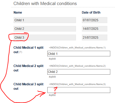

If my data has 3 children with 3 yes values, I see this; (1 & 2 OK but no 3)

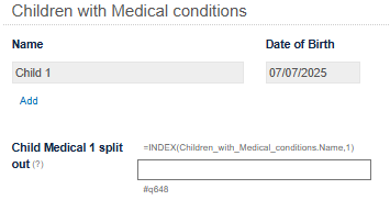

If value 1 = No and 2/3 = Yes, similarly the last value is always missing in my individual field.
If there is only one yes value, it's empty.
