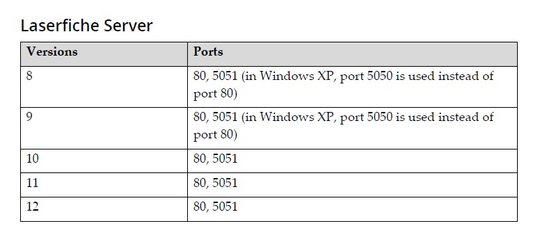

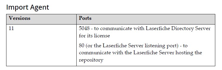

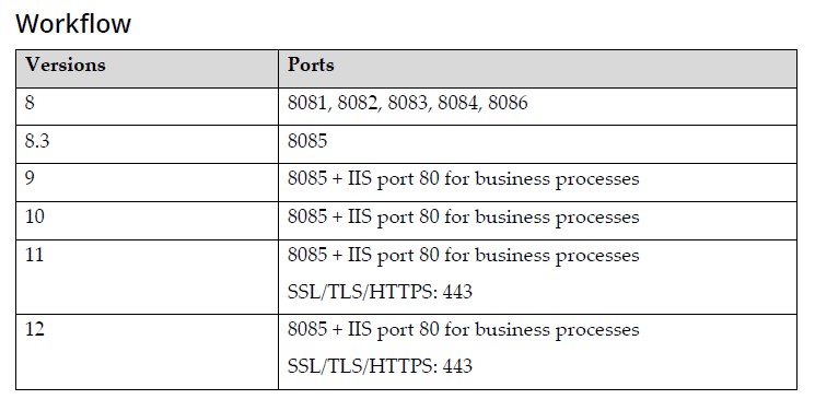

replied on June 25, 2025
A few of the components also use port 80 for administrative tasks, such as Import Agent, Server, Workflow triggers business processes using port 80. There is a really helpful whitepaper out there called "Default Network Ports for Laserfiche Products". The version I have is from February of this year, not sure if there is a newer version.
Hope that helps

replied on June 26, 2025
Important to note that "Default Network Ports for Laserfiche Products" is older documentation, even though the LF12 apps got added in. Anywhere it mentions port 80, there should also be a config option to use https/443 instead.
  • Workflow uses https/443 to communicate with repositories if you have "Use SSL when connecting to Laserfiche" enabled from Workflow Admin Advanced Server Options: General
  • Workflow Business Processes have Repository Server call the Workflow Web Services endpoint (https://workflow.example.com/Workflow) over https/443 when the Workflow Web Services URL is set to an https one, per Workflow Web Service Configuration. The workflow server must have a 443 certificate binding.
    • Note: If you didn't have this URL set to an https one when you published a Workflow business process, you MUST republish it for Repository Server to receive and use the updated https endpoint.
  • Import Agent uses https/443 to connect to repositories when a profile has the "Use SSL Connection" option enabled, per Automating Import from a Windows Folder with Import Agent.
  • Repository Server listens on ports 80 and 443 by default (provided a certificate is bound to port 443).
    • Note: Repository Server traffic does NOT go through IIS. It has its own port 80 and 443 listeners independent from IIS site bindings. While you can set a port 443 certificate binding for Windows through IIS Manager that Repository Server can use (because it's at the OS level), there's no direct relationship between Repo Server and IIS.
    • You can see that by running this command in PowerShell:
      netsh http show urlacl
      Where you'll see Repository Server's reserved URL listeners like http://*:80/lf/ and https://*:443/lf/.
  • Repository Desktop Client and Repository Admin Console both have similar "Use TLS" checkbox options (not enabled by default) when attaching a repository that makes them connect with https/443.
