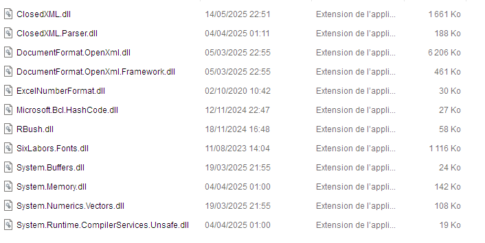

Hello,
Closedxml requires a lot of dependencies to function.
Using it directly from a workflow may not be the right solution.

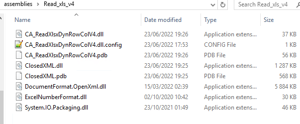

For my projects that need to use Closedxml, iTextSharp, or other files, I create custom activities that have the advantage of locating all the binaries in the same folder.
When the custom activity is created (.dll), a configuration file (.dll.config) is associated with it, which contains the dependencies used.
Regarding the GAG, I strongly advise against registering your DLLs there. It's dangerous and unmaintainable.
