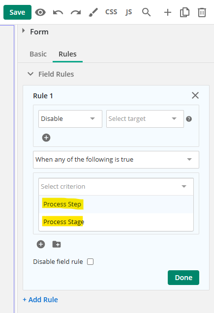

You can even set field rules to make things read only based on the specific stage or step in the process, so there's multiple ways it could be done.

Multiple forms are not necessary and could really complicate maintenance. You can set read-only rules based on the Step Id to reuse the same form, and you can get the step id for each task from the process diagram.

I will definitely check out the link, thank you. I haven't seen anything about how to make fields read-only on a step. I have seen Hide and Show. Would it be disable maybe? ill check that out and the links thanks again the service task to reset will def work
replied two days ago
Yes, it would be enable/disable depending on whether your process works best with inclusive or exclusive rules.
