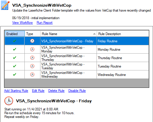

replied on June 4
I ran into a similar problem when I set up a workflow to run every hour on weekdays.  It turned out that using the two types of scheduling together created a conflict.  When I set it up to run with five separate schedules (one for each day of the week) every hour, it worked (and still works) fine.

replied on June 5
The problem existed at the initial implementation which was years ago.  The problem existed when I attempted to have the workflow run Monday through Friday every 15 minutes for 10 hours.  Here is the scheduling that works.
