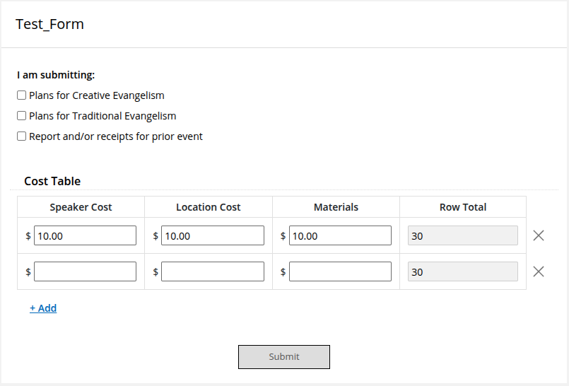

I have this table row. I want to calculate total per row. However, when I try to add a new row, the total is carried over to the next row and calculates a total for both rows. It is like it is summing up all the totals

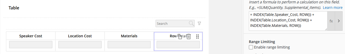

What does your Formula look like to total the row?  It should look like:
  • = INDEX(table.field1, ROW()) +  INDEX(table.field2, ROW()) +  INDEX(table.field3, ROW())

I am getting the following error
Calculation contains a circular reference.
Seems the table is not happy to reference itself when looking at the row
replied on May 21
It works for me without a problem.
replied on May 21
It has worked. I had a formula that was causing the error. Tried with a new table and collection and the formular worked on both.
Thanks so much Bert
replied on May 21 Show version history
Try something like this:
=SUM(INDEX(TableVariable.Field1,ROW()),(INDEX(TableVariable.Field2,ROW()),(INDEX(TableVariable.Field3,ROW())))
