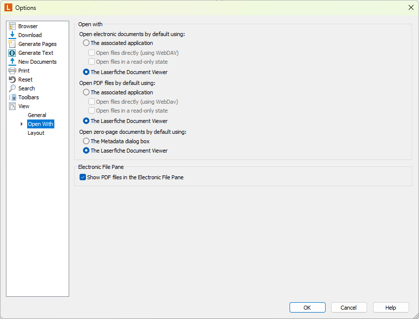

I would recommend checking you and your user are on the same version of the client, and also compare your options for viewing PDFs versus the user's options (Options is in the Tools menu) to see if there are any differences.
Here's a screenshot from mine (version 11.0.2305.274).

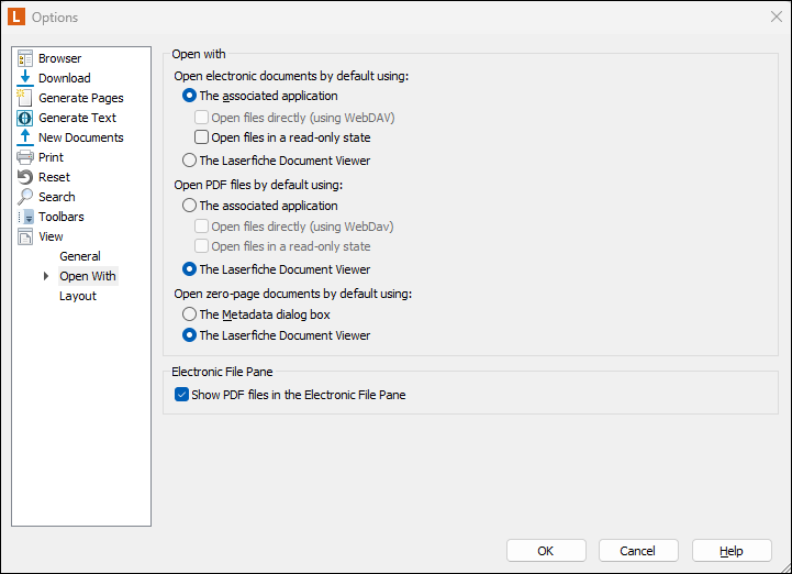

replied on May 20, 2025
Hi Matt,
I checked and the user and I are on the same version. Her options screen looks the same as yours, and mine is only slightly different.

Our help desk says they don't install Acrobat Reader anymore, as MS Edge has the ability to open PDF files. I changed the user's options to open Electronic Documents and PDFs with Laserfiche Document Viewer, but we're still seeing the error on her computer. Shouldn't the built-in viewer work without Acrobat Reader installed?

I believe if you are trying to use Edge as the default for PDFs instead of Adobe Acrobat/Reader - then using the the option to "Open PDF Files by default using: The Laserfiche Document Viewer" is not going to work.  If I remember correctly, the Laserfiche Document Viewer is actually using a component of Adobe Acrobat/Reader to display the PDFs in its viewer.
You likely need to switch the setting to "Open PDF Files by default using: The associated application" instead.
With that change, it won't be trying to display the PDF inside the Laserfiche Document Viewer, it will download it and try to use the default program (in this case Edge) to open it.
