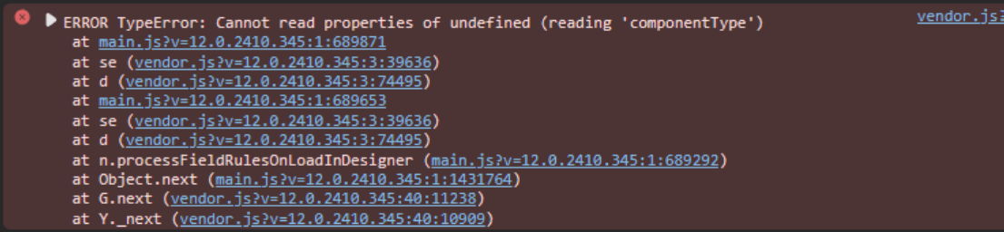

Have you checked the browser console while you are trying to open the form in the designer?
Maybe there is some error happening with the loading process that is causing it to fail, even though it looks like it's still trying to load.
replied two days ago
There is an error in the console, I will post a screenshot below. I verified the vendor.js file is not missing and I can open it with notepad when I first saw this. Maybe the customer accessed a feature that uses a function from this code file and the file has a object reference management issue, I am not sure how I would follow that trail back to see what they did in the software though. They do not even have knowledge of changing anything on the form, they only remember recently unpublishing the process temporarily then republishing it.

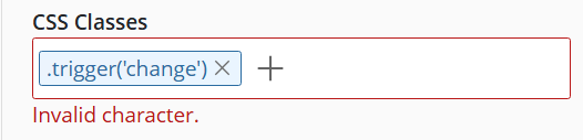

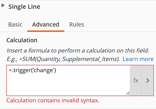

The JS and CSS panes were completely empty but I did find these 2 areas where someone was trying to use JS in both class names and calculation fields. If I remove them, save the form, then download it from my staging environment. I can upload it back to the customer environment and open the form finally!
However this doesn't let me fix their existing process which is in production. I really don't understand why the form is working in my staging environment. Possibly because I am using a build 2503 since build 2410 is no longer available.
Update: I just realized you can not save the form with invalid class names or calculations. So someone could not have put this JS here, it is almost as if though the system did this.

The error seemed to be a known bug #569395 which existed on 12.0.2410.345 and has been fixed on 12 Update 1.
Please check following this: export the bp and search for '<referenceFieldId>0</referenceFieldId>'. If the block could be found then it should be this bug.
A short-term workaround was update 0 to -1 in the above block and re-import the file to overwrite the existing process.
Also we had an individual hotfix for the bug, please open a support ticket if you need it, thanks.
