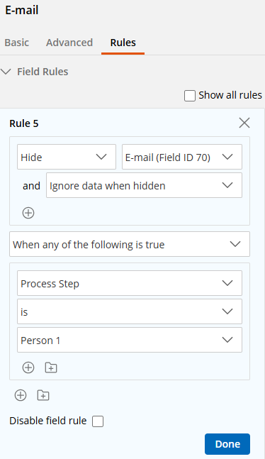

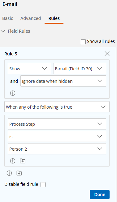

{/_useremail} pulls the current user's email address. If the field is visible, or the data is set up to be saved when the field is hidden, then it would pull the submitter's information.
If you're wanting to get around that and have it pull the email address for a user in a later process step/stage, I would recommend setting it up accordingly using field rules.
Here are a couple options:
Let me know if you have any questions and I can try to explain a bit more.
