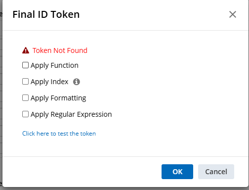

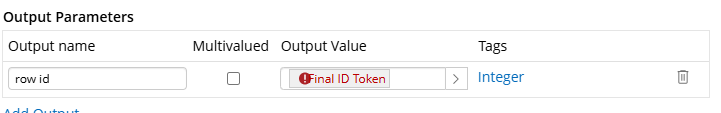

Hi,
Has anyone run into this?
But the token is definitely created:
and it gets modified through the workflow:
I haven't tested to see if the workflow will fail or not. I don't think I'm missing anything.

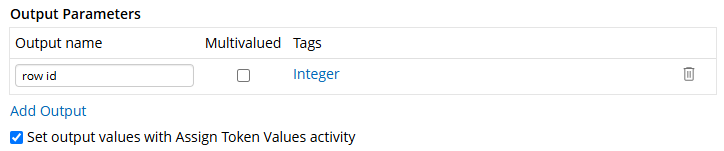

I believe you'll want to select "Set output values with Assign Token Values activity", since that is how your workflow is set up to run.

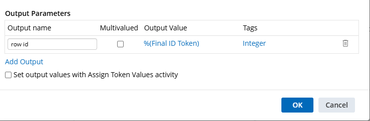

Hi,

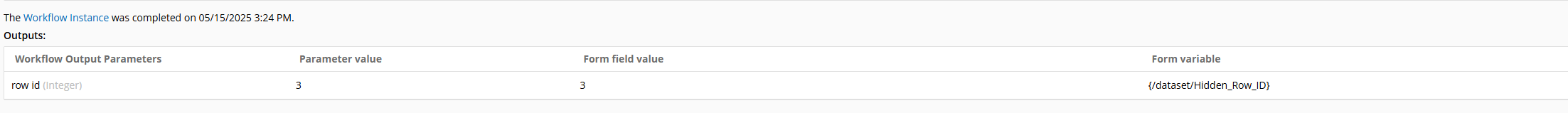

So this workflow is called from a business process to insert input values into a lookup table. By default the lookup table's rows don't have an integer ID (just a key-which I have no idea on returning ASC) so I have that setup in my lookup table. I return the row ID back to the BP as I update the same row later in the process through another workflow by using the ID value. I checked other workflows that are similar, and I get the same visual error, but it works as intended.
I tested this today and it also worked:
I don't think if I selected "Set output values with Assign Token Values activity", workflow would know what variable to send back to the BP. So, I guess I'm just bringing it up for awareness. My workflows work as intended.

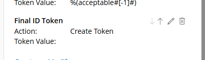

edit: I see now what you meant. You actually have to go into the Assign Token Values and modify there.
