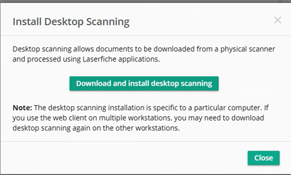

We are having problems with a shared workstation at our police department. It seems that each user is being asked to download and reinstall the Desktop Scanning each time they attempt to scan (web client). We have been troubleshooting and we don't know why this keeps happening!! I'm curious if this is because it's a shared station??
It seems that we started having the problem right after the Chrome extension completely went away. We are running Windows 11 Pro, we have tried Chrome and Edge and are having the same issue.

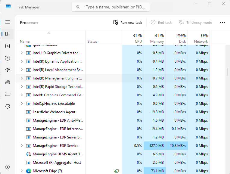

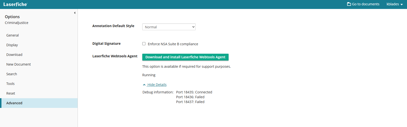

Could you check if WebTools Agent is installed and running on the shared workstation:
Go to Options\Advanced in the web client on that computer, does Laserfiche Webtools Agent show as running?

Hi-
It does show that it's running...please see below.

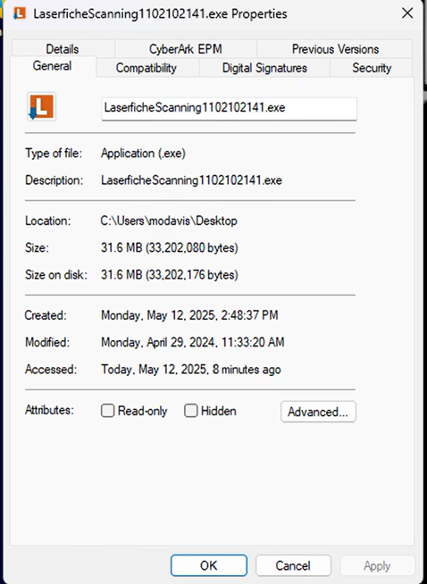

replied on May 14
In your WebScanBuildNum.txt, the expected scanning version is 11.0.2306.201, but installed scanning is 11.0.2102.141.  So that WebClient prompts a upgrade dialog for Scanning. If you have tried to install the downloaded LfWebScan110.exe, then there could be an installation failure.
Could you try uninstall Scanning and Laserfiche Webtools Agent 11 first, then reinstall the LfWebScan110.exe?

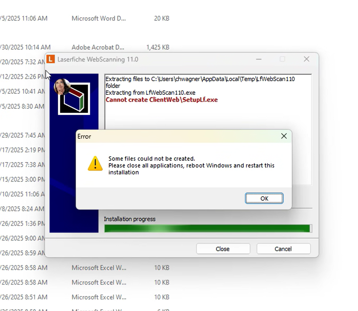

replied on June 16 Show version history
I am really hoping to install scanning and Webtools Agent only on our users laptops. When I look at the failed install, it shows client suite.
replied on June 16
LfWebScan110.exe will only install Scanning and its related components (WebTools Agent and OCR). The name is due to it reuses the client suite installer.
replied on June 17
Thank you. Do you have any ideas on how to fix it?
replied on June 17
For the error in your latest screenshot, please check the folder mentioned "C:\Users\chwagner\AppData\Local\Temp\LfWebScan110", try to delete the whole folder and re-run LfWebScan110.exe
Alternatively, you can use archiving tool (like 7zip) to extract LfWebScan110.exe to another foler and run ClientWeb\SetupLf.exe manually.

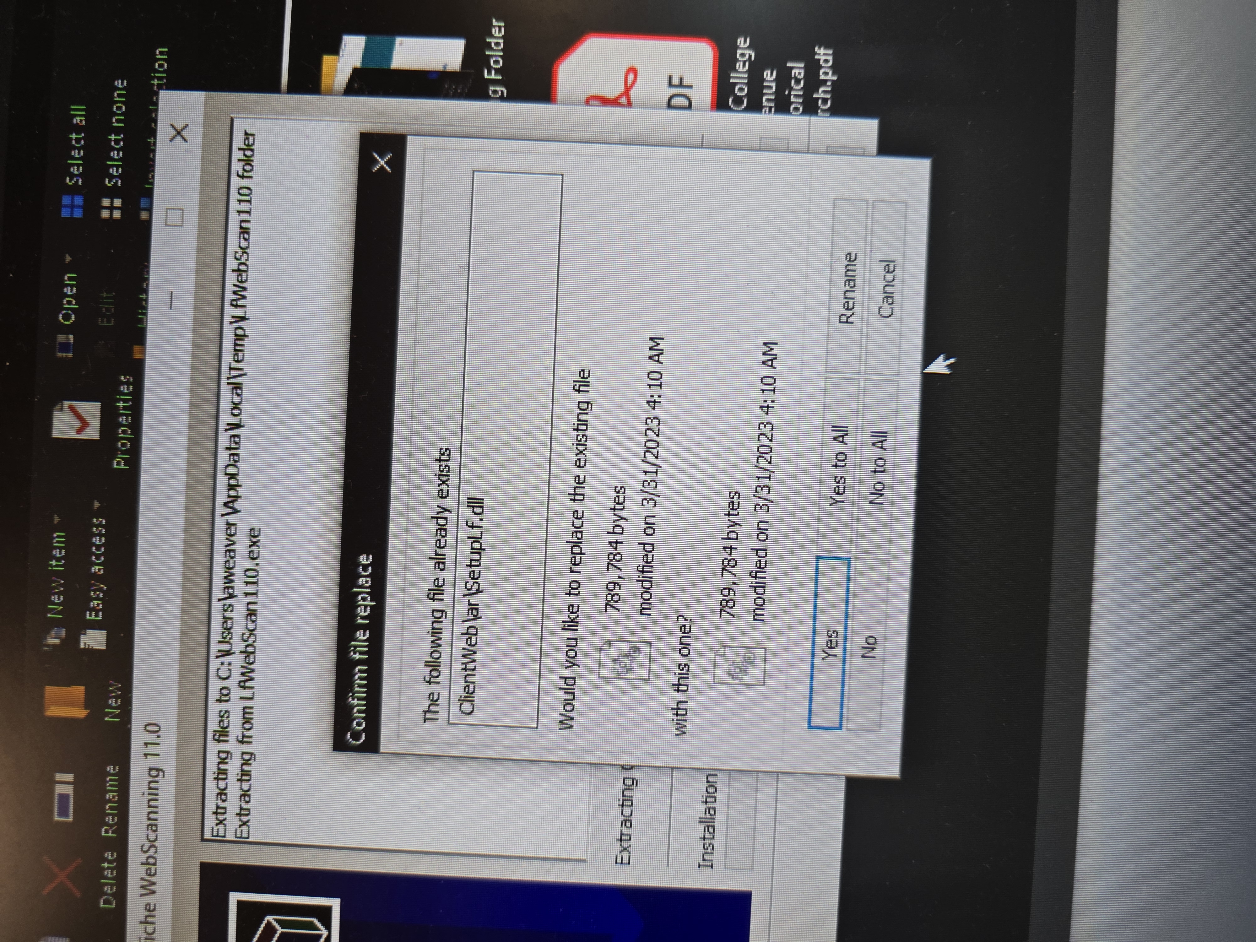

replied on June 24
Is there any way to provide a full list of install files so we can ensure our firewalls aren't blocking something? I can get scan to work but the second the user restarts the computer, then the lfwebscan110 isn't recognized. I have to double click and "replace all", then reload scan and it works great again!
replied on June 24
Screenshot
replied on June 29 Show version history
Scanning should be installed in C:\Program Files (x86)\Laserfiche\Client\Scanning after a successful install.
LfWebScan110.exe is not used any more after you installed Scanning. The temp folder in your screenshot is only used to extract installation files before installation.
