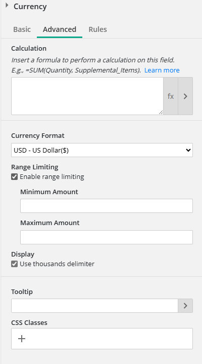

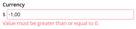

Under Advanced, you can enable range limiting with a minimum value of 0:
replied on May 9, 2025
Oh I am in version 11 with this environment and I don't see this. Maybe it is a feature of 12?
What version are you in?
Darn! I'm on Cloud, but this isn't a new feature as far as I can remember.
Do you have the option in number fields by any chance?

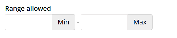

Yea I see it in Cloud. I also checked Version 12 On-Prem and I don't see it. I can do it for any other non currency number on the general tab and it looks like the screenshot below. Only currency does not allow me to set a range in the editor. The option exists because we can access it with JS, but it is not shown and the JS is not reliable.
For example we want to prevent submitting a form with a total as a negative value but the total field is populated as a total of other fields so the field itself is read only.

Check the Advanced tab on the Currency field.  This is from the latest Forms 11

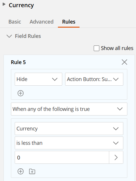

You could also set up a field rule to hide the submit button when the total field is less than 0, if that's an option for you?
Weird you're not seeing range limiting under Advanced though.

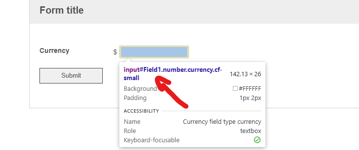

Try this other way:
Create a Custom HTML object near your field. with this code inside:
<!-- Error container for the currency field -->
<span id="err1" class="currency-error" style="display:none;"></span>
You can customize the id="err1" by any number you want. I prefer to put the same number as the input field. I need the alert, that way I never lose track.
Keep the ID you put there, because you need to put the same in the JS code I will share next.
