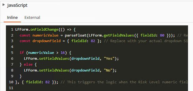

Hi Luis, I tried the code but it's not working. is there any work-around for this if the javascript is not working?

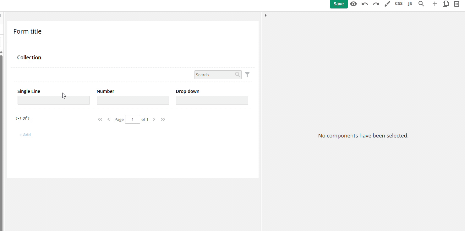

I tried it in different scenarios, and it worked for me. Look at the image I posted here. And try this code, and open the inspection code in your browser in the console tab, and see what error you can see there related to the JavaScript, and share here. I included codes to debug in case have an error.

The code works for 1 row, but not for any additional rows.  @████████ Since the table is repeating are there a specific number of rows or can the end user add as needed?

Hi All, on Rafael screen shot, shouldn't the last line that trigger the field be 80 and not 82?
replied on May 7, 2025
Yes
