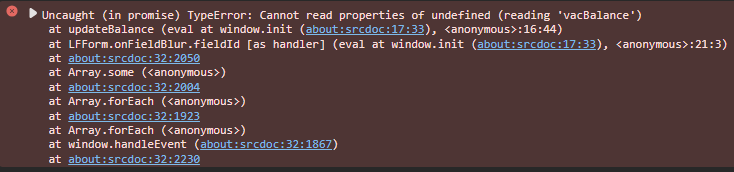

I tried that (using formFields.vacBalance), but got the following error:
Uncaught (in promise) TypeError: Cannot read properties of undefined (reading 'vacBalance')

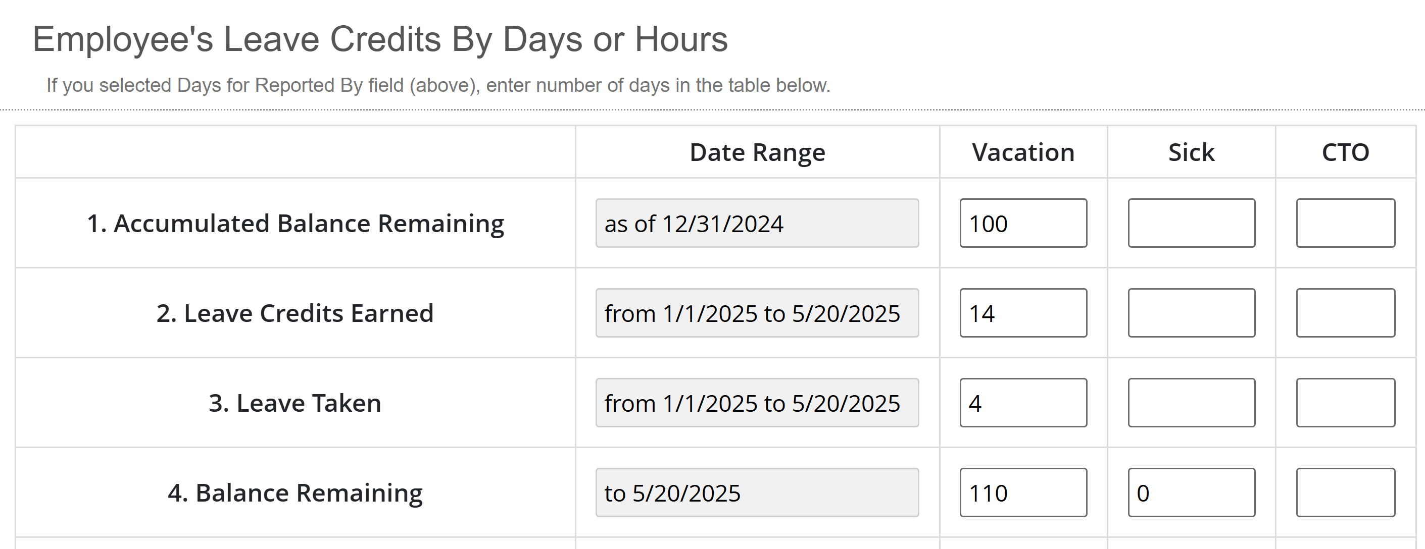

To give you an idea of what is expected in the UI, see the "Vacation" column below:

Take formFields out of your async function arguments; that is creating a new formFields argument for the function, which supersedes the variable you defined at the root level.
This code works for me (with different variable ids for my test form)
const formFields = {
  vacBalance: { fieldId: 22, index: 0 }
const updateBalance = async () => {
  let v = LFForm.getFieldValues(formFields.vacBalance);
  console.log(v);
When you put formFields in the async as an argument, that is not passing the existing variable, it is a separate reference in the scope of the function.
