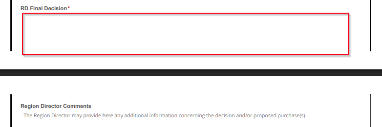

When a particular form was saved to the repository the natural page break happened to fall exactly where a radio button would be located. It appeared to be cause the radio button to not be saved. It should appear in the red box.

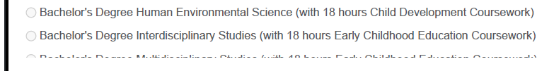

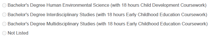

replied on April 29, 2025
This turned out to be very valuable advice as on a different form the radio-button box was so large that it would span a page break regardless and was chopping off the last 2-3 lines when saved to the repository.
Using the .keepTogether CSS forced it to appear on a page by itself which preserved the bottom lines.
