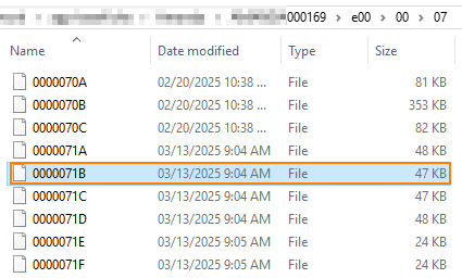

We have a process that is importing electronic documents (.docx) into Laserfiche, that is saving them correctly into the "e00" folders of the volume.
The customer has another application that displays documents from various local sources that they would like to also display these same documents but it can only use a UNC path (no URL's).  This wouldn't be an issue if the electronic files were stored with their original extensions but they are actually stored as type "File".

The Laserfiche repository actually use to store electronic documents with their original file extension in the volume location but moved away from it several years ago.

There isn't a way to store e-docs with their extensions in the volume. Laserfiche does not support direct access (and modification) of files in the volume. Doing so would potentially result in inconsistencies between the database and volume that would affect the functionality of your repository.
