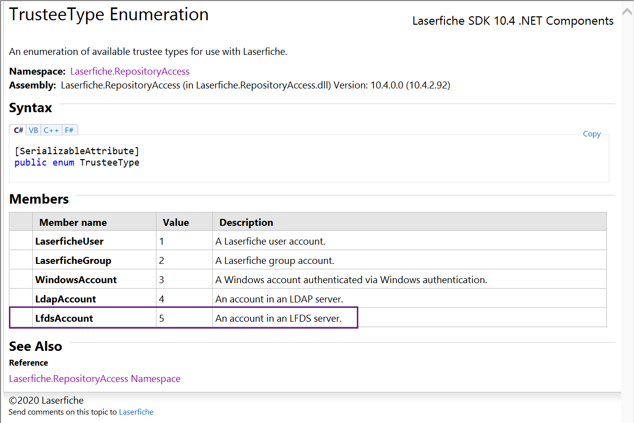

The SDK does support adding LFDS accounts to a repository. While I don't have sample code offhand, you'll want to look at the Account and AccountInfo classes, and the TrusteeType enumeration (used with the AccountInfo.TrusteeType property).
You can see that TrusteeType = 5 is for LfdsAccount
replied on April 23
Hey Sam. Thank you for your response. The TrusteeType Enumeraion is read only.

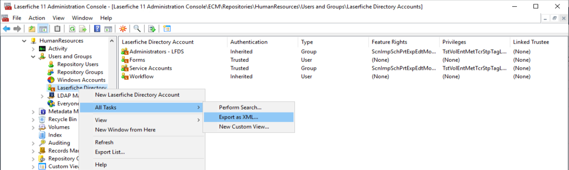

While it doesn't directly address the question, once the groups are registered once, in Admin Console you can Export as XML and then import with Import Repository Objects (with that XML file) to other repositories on the same or different Laserfiche Repository Server instance. Note that this method includes the Features Rights and Privileges associated with the accounts, which you may need to modify after import.
