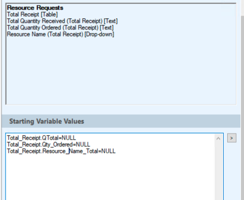

    I tried setting the variable to NULL via work flow, but this is what I am getting in the form.
Am I doing this correctly? This is my Set Business Process Variables task.

When you click on the token, you want to select Special and then use the DB.NULL for the fields you want to clear.
replied on April 21
That worked! Thanks @████████
