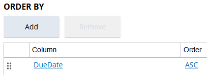

How is your query rule set up? At the bottom there should be an "Order By" section. I would start there.
If that's not the issue, let me know and I can try to help troubleshoot. :)
replied on April 8, 2025
Aha! That did the trick.
Thank you!
Perfect! I'm glad it was something simple haha
