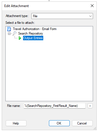

I have a business process that involves a form being saved to the repository, and then that process calls a workflow to send an email with the saved form as an attachment.  The email kicks off successfully, but it always sends an XML file as the attachment.  When configuring the email, what am I doing wrong?
Is there another place where I need to configure something?

It sounds counterintuitive, but you should be attaching the entry, not the file. File should be used when you are referencing the output from the "Create iCalendar File" or "Download Electronic Document" activities.
https://doc.laserfiche.com/laserfiche.documentation/11/administration/en-us/Subsystems/LFWorkflow/Content/Resources/Activities/Email/E-mail%20Attachment.htm

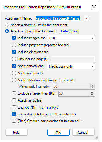

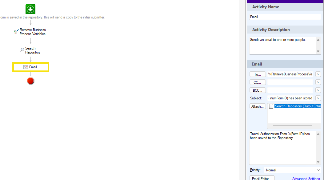

replied on March 21
I changed the attachment to entry, but now I'm not getting an attachment at all.  I'm wondering if my retrieval process needs work.  Is there another step that I need to add after Search Repository?
replied on March 21
You may need a conditional sequence to only email the attachment if >0 entries are returned by the search activity. You likely also need to adjust your search activity to only return the first result, which will eliminate the need to include a "For Each Entry" conditional decision branch.
