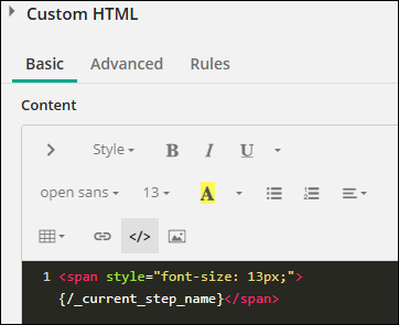

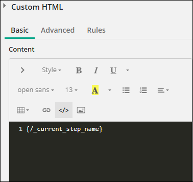

Add a Custom HTML element on your form (you can keep it hidden with Field Rules or CSS if you don't want the user to see it).  Populate the element with the following:   {/_current_step_name}
Note that you want to fill this in on the code view of Custom HTML element, not the formatted text view, otherwise you'll end up with a bunch of extra HTML tags that you don't want.
You want this:
You don't want this:
