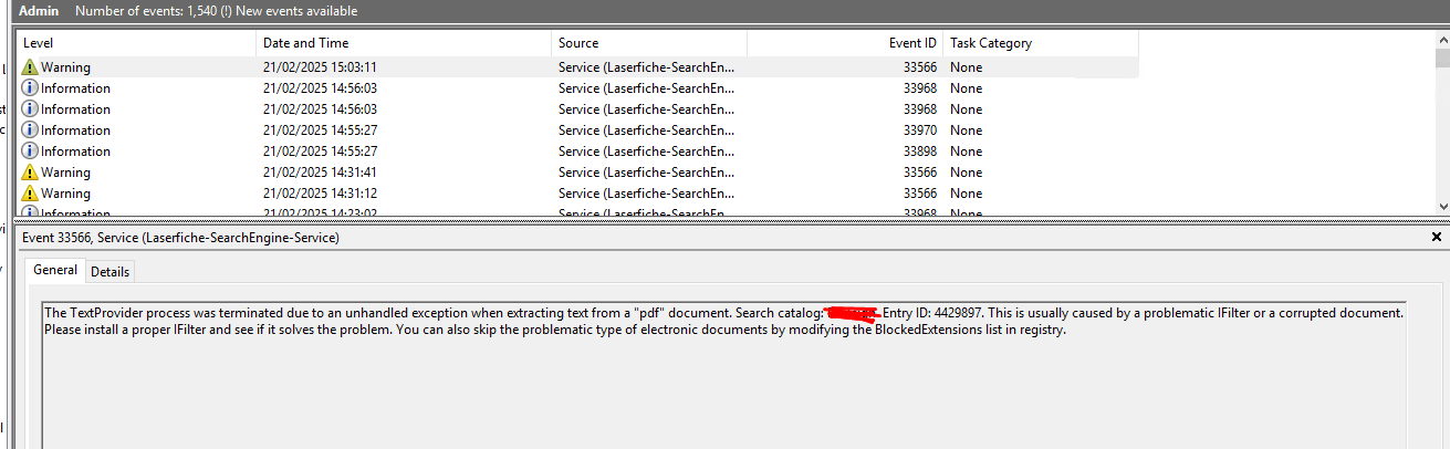

I'm currently running a re-index of our own repository, and looking in the event viewer I continually see the error:-
The TextProvider process was terminated due to an unhandled exception when extracting text from a "pdf" document. Search catalog: xxxxxxx Entry ID: 4429897. This is usually caused by a problematic IFilter or a corrupted document. Please install a proper IFilter and see if it solves the problem. You can also skip the problematic type of electronic documents by modifying the BlockedExtensions list in the registry.
The document itself isn't corrupt and opens fine, and also I've got the latest version of Adobe Reader installed on the server 2024.005.20414 but the error persists.
