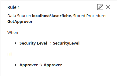

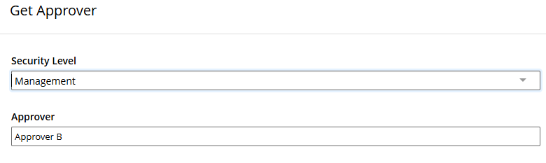

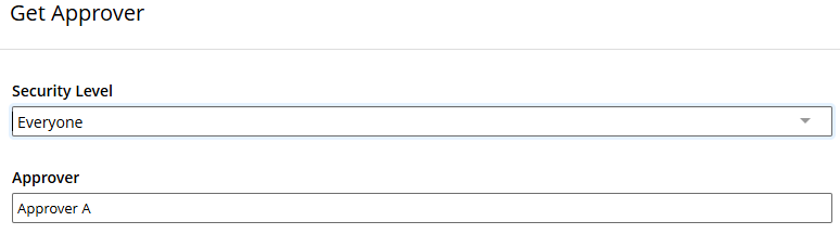

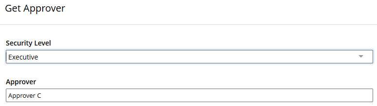

This seems to work ok for me.  I built a table and a simple stored procedure to test with.
Each time I pick a different Security Level, it immediately updates the approver.  The big pitfall here would be if something wasn't spelled correctly.  I'd check to be sure "Executive" is spelled the same in the drop-down as it is in the table your stored procedure references.
I went ahead and tested Angela's suggestion and multiple results will return a blank value in the Approver field.  Here's my table:
This works fine for Everyone and Management but leaves a blank for Executive.
If it helps, here's the lookup rule I used:

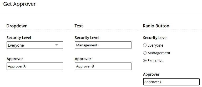

replied on February 21, 2025
Sure... there's lots of things we don't know and I'm probably speculating too much.  I tried out a radio button and a checkbox and found that neither can be used for a Lookup input - at least as far as I can tell.  I did find a workaround but I don't think the input really matters so long as:
1 - There is a single input value
2 - The input value matches a value in the table exactly
3 - The input value has only one match
If there are multiple matches, I found that Laserfiche does actually fill all the values so long as the Approver field is editable:
It just fills them as autocomplete options.

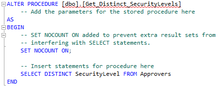

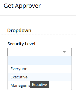

replied on February 25, 2025

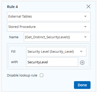

I can't seem to make it fail even filling the drop-down from a stored procedure.  Here's my sp:
Here's my lookup rule:
The dropdown gets populated by the sp:
When I pick Everyone or Management, the field fills automatically.  When I pick Executive, it gives me autocomplete choices since there are two different approvers at the executive security level:
Am I setting up something different than you are?
