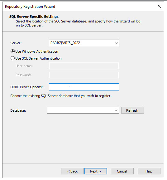

Thanks Miruna - I agree that these are not best practices, but the alternatives are all worse and the timeframe is super tight.  That said, I think found the answer to this specific problem.  Here is a screen that I have clicked by 1,000 without paying attention to all of the options:
That part where you can add ODBC options is staring me in the face.  All I need to do here is to add the parameters, Encrypt=yes; TrustServerCertificate=yes; and I think we'll be done.
We already tested these options using Workflow data sources, so this should work at the server level as well.

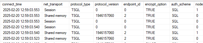

Testing to follow...And testing seems to have worked. Note the encrypt_option column.
