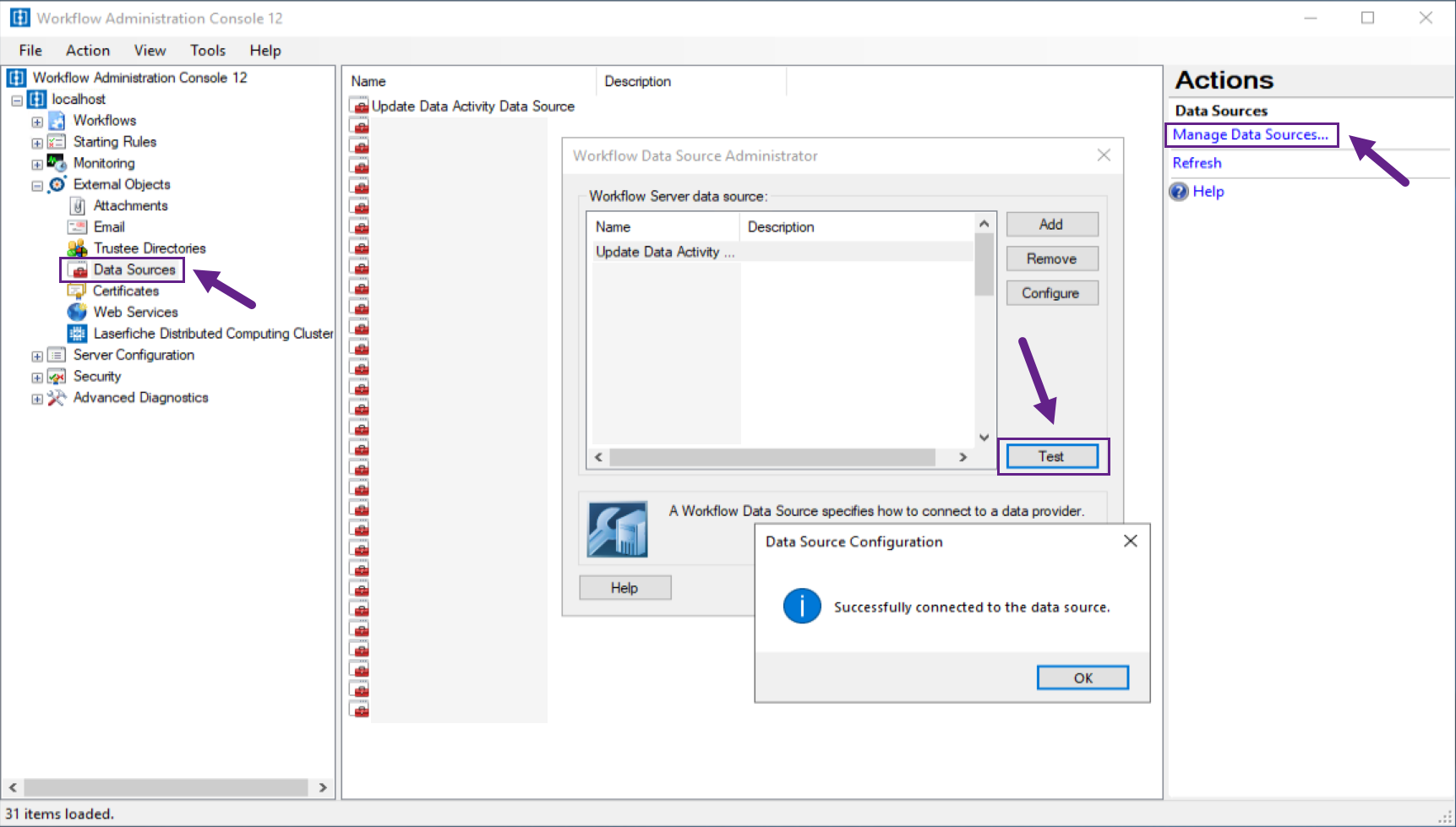

As Workflow itself is generally functioning and only one Workflow is erroring, the SQL error is almost certainly about a connection to an external Data Source. Here's an easy way to find which data source Workflow can't connect to:
  1. Open Workflow Administration Console and connect to the Workflow server.
  2. Navigate to the External Objects > Data Sources node
  3. Under Actions, select Manage Data Sources...
  4. Select the first data source in the list, the select the Test button. Workflow will attempt to connect to that data source. Note the result if it is anything other than "Successfully connected to the data source."
  5. Repeat running Test on each data source in the list.
  6. One or more of them will likely return an error.
  7. Inspect the properties of any data source that fails to connect and check for any configuration values that may not be valid.
Screenshot of the Workflow Administration Console 12 Data Sources interface. The Workflow Administration Console 11 Data Sources interface looks the same.
replied on February 10, 2025
Samuel, this is a fantastic help.  It errored out on the database that I am having issues with.  I now have something to run with.  Thank you so much!

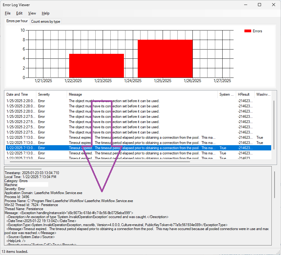

Where you look at the errors in the Workflow Admin Console, you'll see a pane that shows details. The part under <StackTrace> tells us which part ran into issues.
If you're looking at it in the Event Viewer, it should have similar information.
As for information you'd be giving away, it would have the machine name and the WF server service user name (as Thread Identity or Windows Identity). If you're not comfortable sharing that, your solution provider can open a case with Tech Support and provide it that way.
