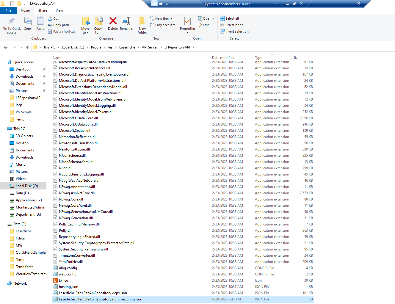

Hey @████████! Recently started working with the Laserfiche Repository API and ran into this issue. We no longer allow dotnet 6 to run internally but I may be able to get an exception granted. Do you know if there's a timeline for the release to support more modern dotnet versions?
Thanks!
replied on May 21, 2025

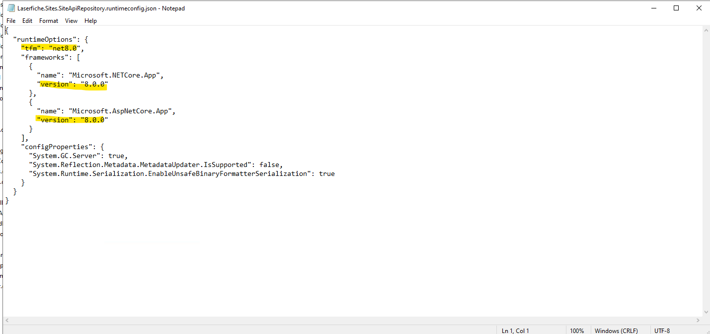

Following up on my reply from yesterday. We were able to find what may be a workaround for this. The *runtimeconfig.json file located in the install directory can be modified to force dotnet 8. We tried this and are at least able to connect to the site without a dotnet error. Unsure if we will run into issues while sending calls but wanted to share in case anyone else comes across this post.
replied on June 2, 2025
I did verify that John, solution to force Laserfiche Repository API to use dotnet 8 does work. In summary:
  1. Install ASP.NET Core Runtime 8 Hosting Bundle for Windows
  2. Replace "6.0" with "8.0" in file "C:\Program Files\Laserfiche\API Server\LFRepositoryAPI\Laserfiche.Sites.SiteApiRepository.runtimeconfig.json"
  3. Navigate to IIS Manager - Application Pools and restart LFRepositoryAPI
