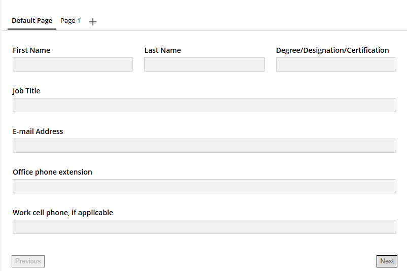

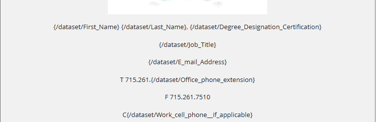

I am in the process of building a new form for business card ordering.  they want to have the end user enter in their information on page 1 and then on page 2 display it as if it was a business card.  I have tried doing an HTML and a Rich Text field to display the dataset fields from the first page but I get nothing.  Is there a way to display that so they can see what their potential business card will look like before hitting submit?
I am attaching both Page 1 and page 2 of my form.

Heya Kristin,
I believe this post can answer this for you. Instead of using the variable name, you'd change it to a <span></span> or similar HTML element that will have the nominated ID for the field that represents the field its pulling the value from, then use JavaScript to enter it into that HTML element. This would only need to be done on the form before it's submitted or at the current task, as the variable doesn't actually hold any information until the form is submitted. If this goes to a second task then you can use exactly as is in your screenshot.

Is this for when it saves to the repository or sends as an email attachment? If it's saving the form that has the JavaScript on it, then it likely won't work as intended as the timing will be missed for it to load. I'm not too familiar with it all, but I have developed plenty of forms that have a similar concept.
When I have a form that uses JS to manipulate a HTML field that also needs to save in the repository or sent as PDF in an email, I like to duplicate the form so that it has a 'saving copy'. On the saving copy I remove the ID's from the <span></span> HTML elements and replace them with the corresponding variable.
As an example, <span id="field1"></span> becomes <span>{/dataset/field1}</span>. This allows the variable's data to load into the element when it becomes a PDF. If you have a different scenario then feel free to post screenshots or more in-depth descriptions and we'll try to help
