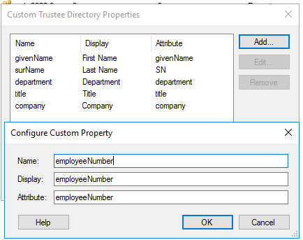

Hi Chris,
If you want to get user's employeeNumber attribute in Find User activity, please go to Workflow Admin Console -> External Objects -> Trustee Directories; double click the Active Directory you have configured. Add custom property employeeNumber there.

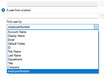

Go back to Workflow Designer, select the AD source in Find user activity. Test and run to see if user's employeeNumber could be got. If want to run a search based on employeeNumber, please select the employeeNumber there.

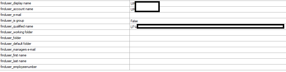

So this is very helpful but have a few questions on this.
1.  I did set it up and found the employeeNumber in my available choices but am not getting a hit.  I am using the same number from the original screenshot above so I know that number should be there.
I changed the search back to the specific user and found them via typing in their username just so I can get a return.  I found the user and the token tracker seems to show the employeenumber at the bottom but its empty.  From the screenshot in AD the user has an employee number but Laserfiche doesnt seem to be able to search on it or find it as a token.
Edit - would there be rights to consider here?  Does it use the workflow service account to query AD in the Find User activity?  If you can get a hit is it all or nothing?
