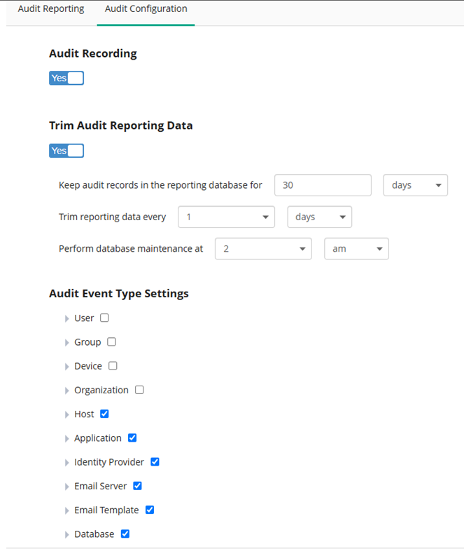

Below are the configurations:

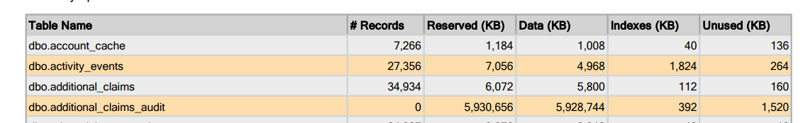

Disk Usage by Table

You can see that the "audit" related tables in the LFDS database do seem to be the culprit. If the customer does need to keep 30 days of audit reporting data in the database, and they can spare the disk space, then it may be better to just leave things as they are.
However, if the database size keeps growing in an unconstrained fashion, or disk space is a concern, or the customer just wants to clear out the audit reporting data from the database, then open a support case and let us know the exact version of LFDS used. We can provide scripts to drop and recreate the affected tables.
