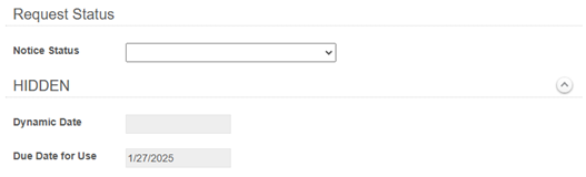

I have a variable which calculates the due date I want to use for that form instance.  For the example I am showing, this is the variable values when I open the task:

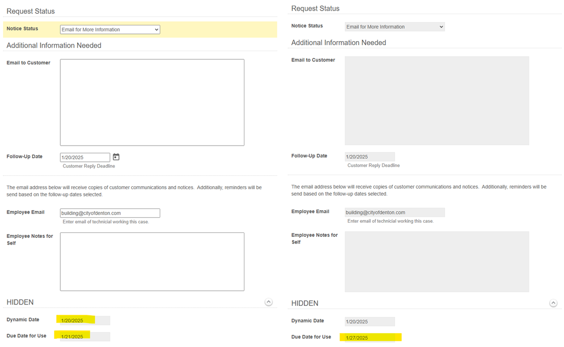

Below on the left, I have the variable values after I have updated the form.  You can see that the Dynamic Date and the Date for Use have both changed.  The values on the right are the variable values that exist in the new task.
Has anyone encountered this or know what might be causing this to happen?

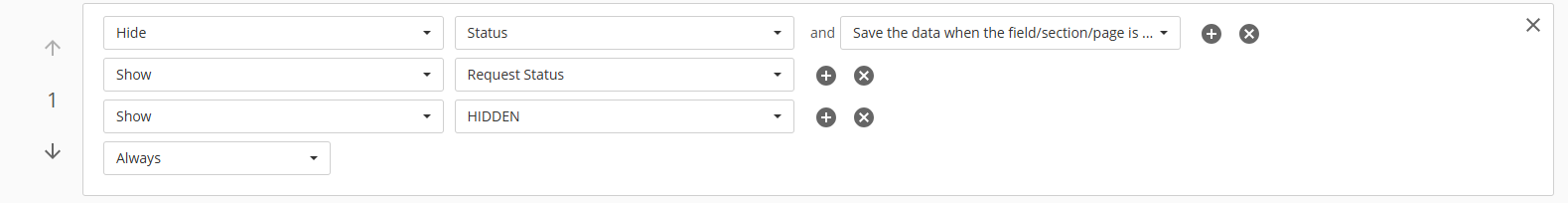

Are the fields hidden by Field Rules - and if so, is it set to save field values while hidden?
replied on January 13, 2025
They were, but I just unhid the entire section 100% of the time and they are still not saving.

And you've checked the Monitor page to confirm that it is not saving the field value for the Dynamic Date field correct?  Just ruling out that it isn't recalculating it back to the old value in the later task.
Yes.  Monitor is showing the same variable value.  I just cannot figure out what I could be doing wrong.  Logically.... it just doesn't make sense.
