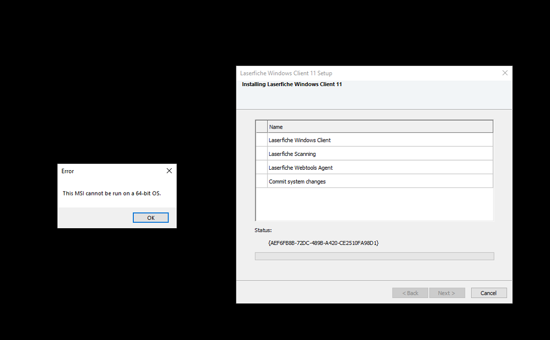

I had a client come to me with the strangest error today installing LF Windows Client 11.
Obviously this can not be true as it is a Windows app and Windows is going to include 64-bit support in most cases.
What could cause it to say such a thing?

The Laserfiche Client Suite applications (some of which are 32-bit) can be installed on x86-64 Windows operating systems and have been thousands of times.

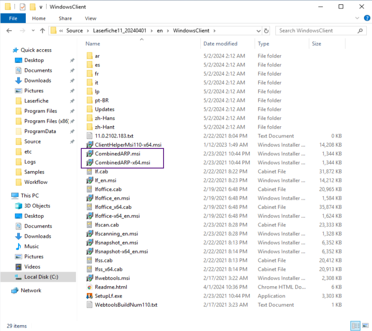

Recall that SetupLf.exe launches underlying MSI installers. We checked the installer code and this error message being thrown suggests there are installation files missing from the installer directory. Specifically, it suggests one or more x64 install files are missing, so it's falling back to the x86 (32-bit) installer, and then throwing the error because the 32-bit installer isn't supposed to run on an x64 OS. Most likely (but not necessarily) the "CombinedARP*.msi" files:

However, rather than doing a bunch of work to figure out which files are missing, I'd recommend they simply get a fresh, intact copy of the installation package from the Laserfiche support site and try again with that. If they manually broke up the install package directories for any reason, don't do that this time and see if it works.

The error details are [PID: 10236] 11:42:46.823 Failed to install Laserfiche Client Suite ARP handler (CombinedARP-x64.msi). Fatal error during installation.
What is ironic is this file, with x64 in the name, when run directly gives the same error message You can not install this on a 64-bit OS.

As I understand it, what's likely happening is that the x64 installer is failing (for whatever reason - we're investigating in the case), and then automatically falling back to trying the 32-bit version in the background, which is what's really throwing the "You cannot install this on a 64-bit OS error".

This isn't about the 32/64-bit attribute of the Laserfiche Windows Client (etc.) software itself. It's a property of there being two different installer bootstrappers that specifically target 64 and 32-bit OS architectures respectively, with those installer bootstrappers coded to only run on the matching OS architecture.
The error message "This MSI cannot be run on a 64-bit OS." is one we wrote, and it appears when the 32-bit installer bootstrapper (again, unrelated to the actual Laserfiche Client software being 32-bit) detects that it's being run on a 64-bit operating system.
To try to restate that in the clearest possible terms, the 32-bit installer bootstrapper has a prereq check function like this:
if ($WindowsOSArchitecture DOES NOT EQUAL "32-bit") {
Throw error ("This MSI cannot be run on a 64-bit OS.")
