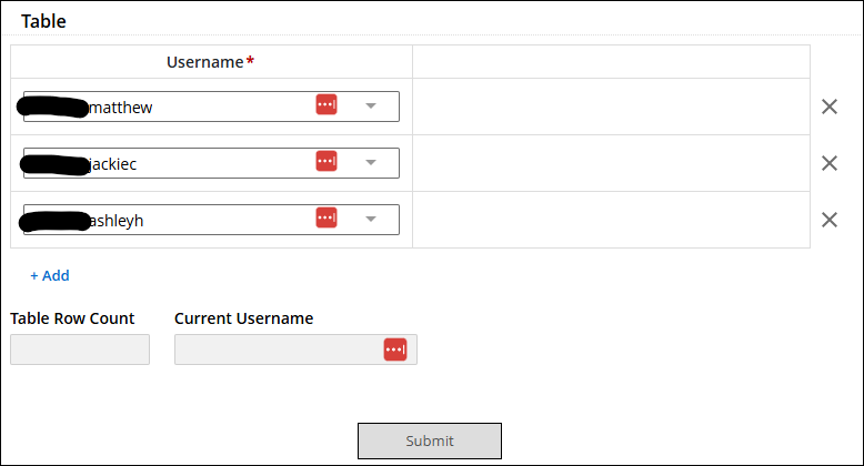

The form itself has three parts:
  1. A table with a username field.  Username is likely something like a lookup populated dropdown.
  2. A number field outside the table (hidden on the form) with a variable like table_row_count.
  3. A text field outside the table (hidden on the form) with a variable like current_username.
The fields #2 and #3 are shown in this screenshot, but they will be used by Workflow, not the form, so they don't need anything populated on the form, and can be hidden.

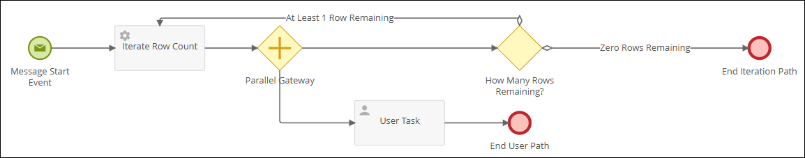

This is what the Forms Process looks like:

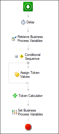

This is what the Workflow looks like:

    1. Delay - waits 1 Minute - this delay exists to ensure that the other steps in the Workflow can run in-between each iteration of the Workflow.  It does mean that there will be 1 additional minute of delay in the process for each additional row in the table.
    2. Retrieve Business Process Variables - gets table>username variables from the form, along with the table_row_count variable.
    3. Conditional Sequence - this will only be triggered on the first iteration of the workflow - the condition is checking that the table_row_count token pulled in from step #2 is empty.  It'll be populated in the first instance, so it will only be true the first time.
      1. Assign Token Values - Modify Value - this is updating the table_row_count token pulled in from step #2.  The value populated in it is based on the table>username token pulled in from step #2, and running the "Value Count" function on it - this basically counts how many rows were in the table.  In this example, it's 3.
    4. Token Calculator - this takes the table_row_count token pulled in from step #2 and subtracts 1 from it.  In this example, it's now 2.
    5. Set Business Process Variables - pushes two values back into the form - filling in those two hidden fields outside the table.
      1. table_row_count will be populated by the new value from step #4 (in this example, it is 2).
        1. table_row_count=%(TokenCalculator_New Count)
      2. current_username will be populated by the value for the current row (the table_row_count token pulled in from step #2 and/or updated in step #3.1 - it is 3 in this example) of the username field in the table (the table > username fields pulled in from step #2).
        1. current_username=%(RetrieveBusinessProcessVariables_Table\username#[%(RetrieveBusinessProcessVariables_table_row_count)]#)
  3. Having complete the workflow, this example now has a table_row_count value = 2, and a current_username value = Ashley's username.
  4. The Parallel Gateway will lead in to two separate paths.
    1. User Task will assign a task, using the value in the current_username field.  In this example, that task is assigned to Ashley.
    2. The Exclusive Gateway will check the if the table_row_count value is >= 1 (which will return to the Workflow) or if the table_row_count value = 0 (which will end the path).  In this example, since table_row_count value = 2, it will return to the Workflow.

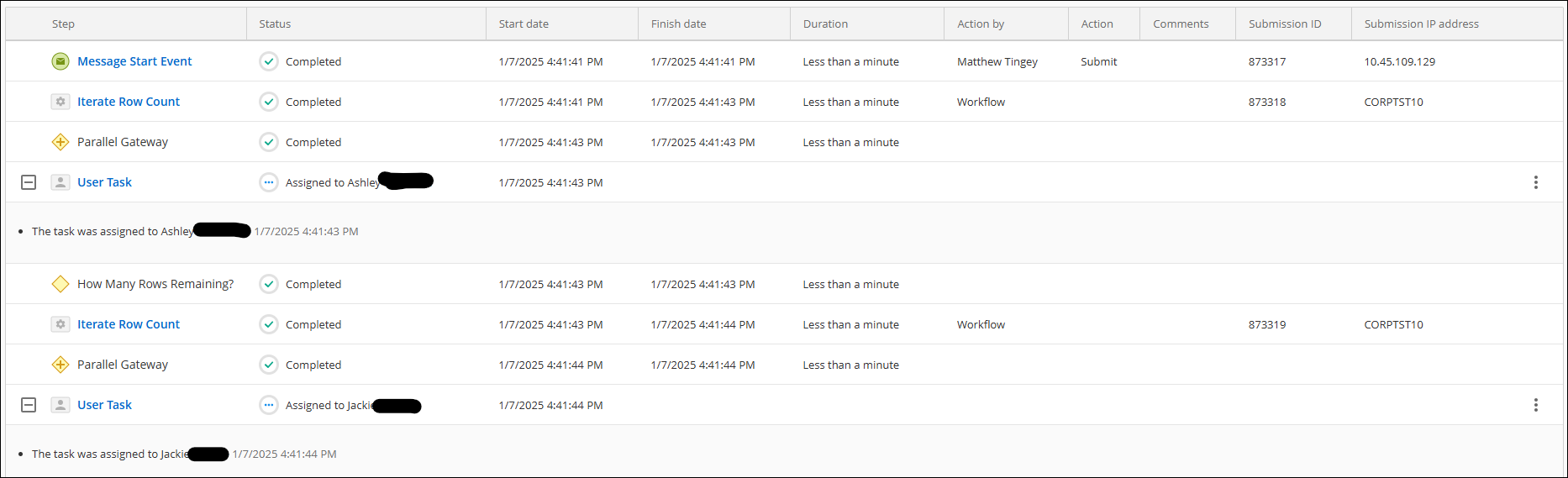

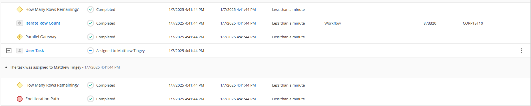

Here's a screenshot of the process following this example, and showing the tasks assigned to the three users:

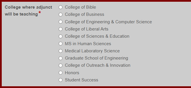

I have several forms that behave like you are describing.  I work at a university and some approvals have to go through department heads, chairs, and deans, and some approvals only need a dean's approval.  When the admin completes the form they make their choices from radio button lists.  Field rules hide and show the next appropriate radio button list. The top level looks something like this...
As the admin selects at each level the next appropriate radio list is shown...like this
The value of each radio button is the name of the LF team it should be assigned to.  As they make their choices the list of LF teams is built from the values of the chosen radio buttons.  In this case as shown above, this list has three teams that it will route to.  At any point the current approver can send it back to the admin to make a correction to the form, which starts the routing all over again.
I use a table that adds a new row each time the form routes.  The approver's approval is recorded on the new row of the table and the whole history is viewable to each approver.
Because the form is linear and is passed from approver to approver, a slow approver can hold up the process.  I've found this form to be a great use-case for Reminders.  The approver get's a reminder every 24 hours to complete their part.  I consider this the squeaky wheel step.  :)
