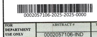

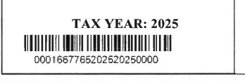

replied on January 7
I've attached two examples.  Barcode Sample1 is the original version and is 22 digits. This has been the standard for years. Barcode Sample2 is new and is 25 characters with the dashes.  Would reformatting the barcode be a complicated undertaking?  The Workflow does look for 22 digits as a condition for identifying valid documents.
Exactly. I would add that, if the dashes are always in this position and the data is always numeric, the barcode identification regex would be:
^\d{22}$|^\d{10}\-\d{4}\-\d{4}\-\d{4}$
This allows the barcode value to either be 22 numbers or groups of 10, 4, 4, and 4 numbers separated by dashes. Here's a link that further explains what this is doing: https://regex101.com/r/i0G32b/1. You can modify this to match your exact identifying conditions if this is not accurate.
